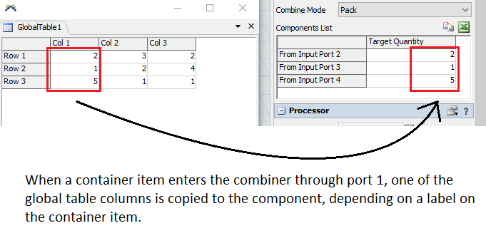

2. The default way to change the combiner's components list is through the pick option "Update Combiner Component List With Labels" in the OnEntry trigger. This option assumes that you have set up a global table in which each column represents the component list for the corresponding value of the label you use in the trigger option.
To change the value between one and three you would first assign that value to a label (which you already do) and then refer to a global like the following to set the list.
Since in this case the column number and value are equal you can also add that option to the trigger and then customize the code to use the empirical value directly without needing to use a global table inbetween.

  1. I was able to create the OnEntryTrigger, Update Combiner Component List With Labels but to be honest I'm not sure what I'm doing with this. What for do you use a global table in the first time? I also don't understand why the global table has 3 columns? Where do I put the information of the globla table? I've tried to put it in the component list - target quantity but I guess I didnt do it correctly.

1. The default "Update Combiner Component List" option in the entry trigger uses a global table to store the different lists/quantities that are then copied to the internal list of the combiner. Each column of the table represents one possible list of values where the rows are the quantities that should be received through the 'item-ports' starting with port number 2.
An example: The following table has three possible lists for the combiner. In the first case it would wait until it has received 2 items through port 2, 1 item through port 3 and 5 item through port 4. The second and third column change these numbers to (3, 2, 1) and (2, 4, 1) respectively.
