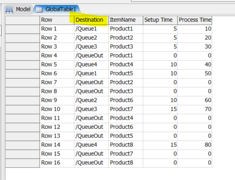

1.The token is not reading the destination from global table correctly. How to enable a "drop sample icon" so I can pick the queue that I want?

Hey @Howard, firstly, if you want the setup and process time of your processors to be determined by a variable value, you can't use "token.SetupTime" since the Processor doesn't know what "token" is. An alternative is to do a Global Table Lookup based on the item's type (if they have different types) or the "If Item Label Value Changes" option for when the label value changes -- then you can setup different processing times.
Concerning your Global Table, if you want a pointer cell value, you need to assign that cell to have that type of data.
If you right-click on the cell, you can assign it that type of data. You can highlight all the cells you want and mass-edit them like this. Then you'll get the dropper to select the object you want.
Another way is to do "Model.find(token.Destination)" to do a lookup on the string you have saved in the table. This will return a pointer to that object that you can store on another label.

Hi Kavika,
I was able to fix the Destination by setting the cell type to pointer. If I want to use the alternate method, where do I put the "Model.find(token.Destination)" ?

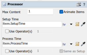

In doing so, we can also get the Setup and Process times off the Global Table and put them on the item in the 3D space. That way the Processor can actually read the item's setup and process time.
And the Processor's quick properties:
Hope this helps.
