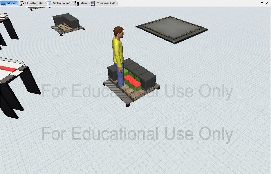

Here we made 3-sequential-combiner
and here those you have 'hidden' or 'gathered' combiners into one. Now it may not be clear, but operator did everyting in a right order.
Message 16 of 18
