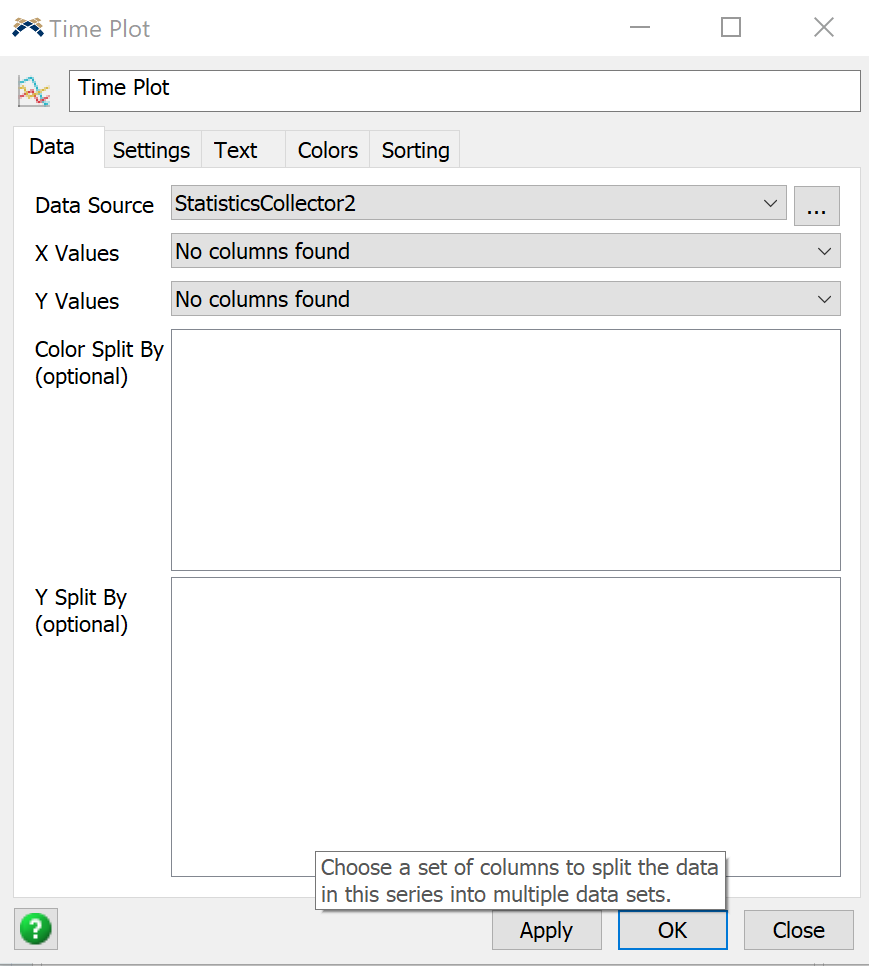

Hello @Christopher H4,
The data can be plotted using a graph called Time Plot. The only thing is that you would need to figure out how to get all the data into one table. There are statistics collectors and calculated tables that can be used to compile data. I am not sure how to move an array into a table.
joerg_vogel_HsH
You can use a Table.query from an array to transform the array into a table. @Jeanette F
