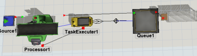

1. I'm setting the button function to produce and eliminate the copied process, but sometimes it can produce successfully, and other times it can't display the copied object in the model, showing an error like the one in pic1. Repeatedly pressing the produce and eliminate button might resolve the issue, or it may continue to show the error. Is this error related to the issue mentioned above?
2.Based on your model, since there are many CPs and AGVs in mine, is there a way to build the connectors using a loop?
pic1.
pic2
