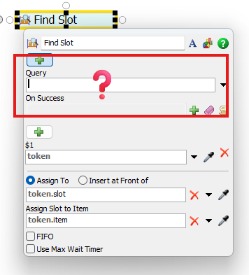

In Find Slot (Query), how should I write the query when:

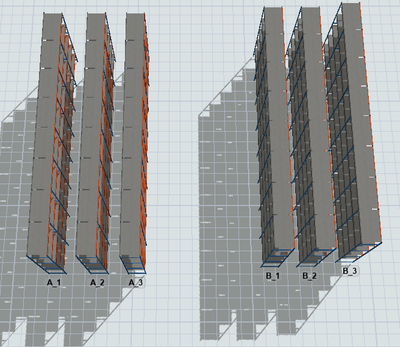

  • There are racks divided into Zone A and Zone B.
  • Zone A has aisles: _1, _2, and _3.
  • Zone B has aisles: _1, _2, and _3.
Each product is represented by a token = $1, and each token has the following labels:
  • token.Type can be 1, 2, or 3.
  • token.lot can be A or B.
The query should:
  1. Separate products by lot, matching the correct Zone.
  2. Separate products by Type, so that items of the same type are stored close together.

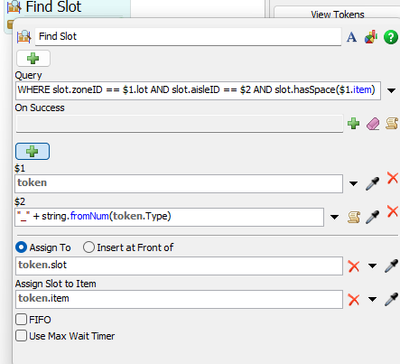

Assuming you mean that the type should match the aisle, it would be the following.
