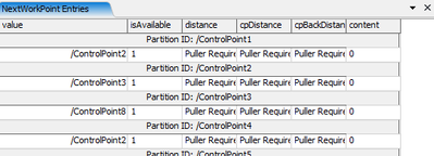

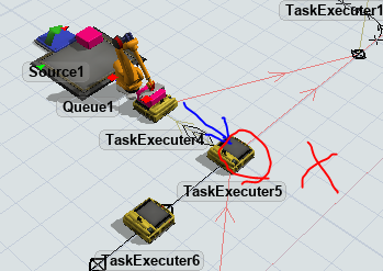

I'd like to know if I can give each of these two waiting times a status so that I can better collect statistics when collecting data! I'd like to make a small improvement to a detail like the one in the picture. When I have a car about to come out, there shouldn't be a car at that point! I'd also like to know how you push those lines or points into the list and some of your logical designs in the model.
Message 10 of 14
FelixMoehlmann
Just set different states in the code that determines the maximum wait time.
The CP at the intersection should only allow a single allocation and the station Process Flow should wait until the current AGV has arrived at it before trying to pull a new one. That will prevent AGVs travelling through each other. In the example I changed the deallocation timing of the intersection CP to improve the vehicle flow.
The lists are a feature of the AGV connections. There is a checkbox in the network properties to create them. They will be partitioned by control point and each partition will contain the other CPs the control point connects to. They are also used in the AGV Process Flow templates which the logic is inspired by.
