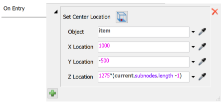

I am having problem with this model. How can i stock one pallet with items over another one changing the z position after the combiner ?
I attach my model below. The problem here is that the combiner send the pallet to the random port without putting them one on top of the other. How can i achieve this goal?

You can do an on entry trigger that changes its position in the z-direction or you can use a rack and change the height of the levels to fit the pallets.

Hi Jeanette the model is to be done in a floor storage. Do you know how can i change the z-direction dinamically on entry trigger?
Thank you very much
Jeanette_Fullmer
