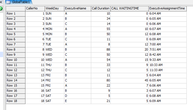

Hi @Jason Lightfoot
Thanks for your reply, I have this kind of output here I need to minimize the call waiting and have to tell no of executive required in a shift ( Assumption every Executive has 7 hours of shift only)1706806707729.png
I am doing excel analysis on this output to solve the problem.
But unable to do same by using OptQuest.
