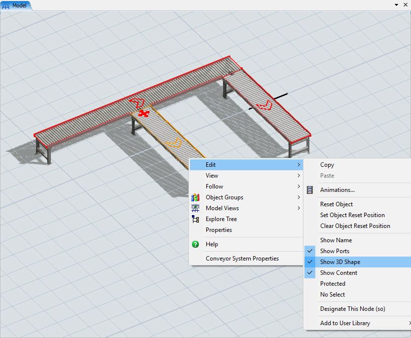

Right-click conveyor and uncheck "Show 3D Shape" under Edit menu as shown here:
If more than one conveyor is selected, it will apply to all conveyors selected.

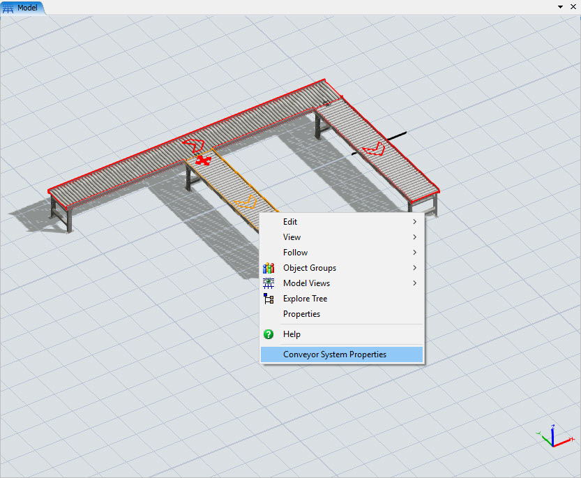

If the "Draw Render Mode" box is checked in Conveyor System Properties (which it is by default), you will have to uncheck it as well, by first right-clicking a conveyor and selecting Conveyor System Properties menu as follows:
And then unchecking the "Draw Render Mode" box as follows:
