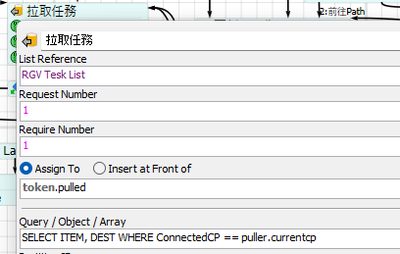

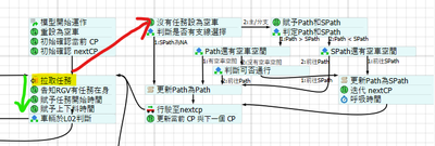

Tasks are pulled in the activity marked in yellow. Wait times for tasks would best be implemented as a maximum wait time in there. If a task is pulled the token continues in the same block of activities (green arrow). If no task is pulled, the token is released to the top right (red arrow). Any delays depending on a task being pulled or not would thus be implemented at those points.

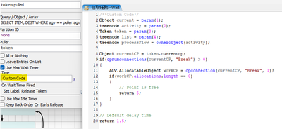

First you need a way to reference the "workcp" based on the control point the AGV arrives at. In the other model this is the purpose of the WorkForwarding connection. In this model those connections are drawn in the opposite direction though (from workcp to "waitcp"). Many of the pairs also have a purple "Break" connection going in the opposite direction but not all. I am going to assume that all stations where this wait time should be applied will have those connections.
Then you can check if the workcp is allocated like in the other model and determine the maximum wait time based on this.

I can't help you there much. All I can say is that this performance meausure shows the throughput of the activity marked in red in the screenshot below. I don't now if/when/why tokens are supposed to move through that section.

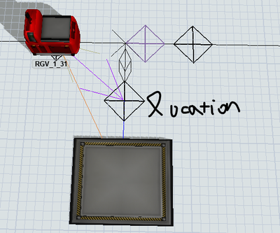

I tried adding a new point connection to change the starting point of this logic, but I don't know why it generates an error message. I also want to know what will happen if I connect two cp points to one object.
Message 12 of 40
a4225283
Why do I need to add extra points like this? Because I need to assign tasks only when the car hits the CP point, but my detour path does not necessarily reach the point. So I want to judge at some points whether there are tasks at these points. Do I need to send the car there to accept the task?

The "connectedCP" list field and query is currently set up to expect a single CP. You could change this though so the field instead stores an array of all CPs connected via "point" connections. The query would then be changed to check if the current CP of the AGV is part of that array.

There might be other CPs that are missing a connection as well. When an error occurs, put a stop time at the time of the error and check the token moving through the activity mentioned in the error message. Check if all labels are make sense and if the "currentcp" has a NextWorkPoint connection. The code for the "nextcp" label in the marked activity seems to be responsible for most errors. I edited the expression for the "currentcp" label value because the previous code didn't make much sense (was needlessly complex).

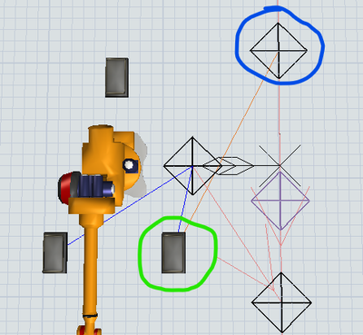

In the "connectedCP" field you are pushing all controls points connected as a "Location" to the array. These are not part of the NextWorkPoint loop though. The queue the item is in when pushed to the AGV work list (I assume its the one marked with green in the screenshot below) needs to a have connection (for example the "point" connection you had earlier) to a CP that is part of the NextWorkPoint loop and ahead of the spur path (blue). This connection then needs to be used in the "connectedCP" field instead of Location. That way, an AGV that is arriving at the blue CP can pull the item/task.

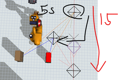

Hi sir, my model doesn't have any major errors right now, but what I want to do might be a little different. When I touch a point, I should be assigned a task to pick up the goods at the location; otherwise, it should just pick up the goods at the point, which isn't what I want.
Message 19 of 40
FelixMoehlmann
I am sorry, but your sentence doesn't make much sense to me. What is the red arrow and 15 supposed to show in the screenshot?
When a token is pushed to the AGV task list, the "connectedCP" field gets all CPs that are connected to the object the item is in with a "point" connection. When an AGV arrives at one of those points it can pull the task token. How long it waits at a CP still functions like in the example model I provided in another post. If the CP the AGV arrived at is connected to a different CP with a "Workforwarding" connection (the connection must originate at the CP the AGV is at), a check is made if the connected CP is allocated or not. If not, the wait time is 5s. If yes, or no such connection exists, the wait time is 5s.
Message 20 of 40
a4225283
This picture mean  the wait logic because I see my car will load item at my “point” cp  !  This picture is mean the car will be asign task than walk to location point
