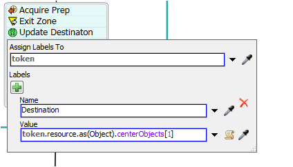

I have a label that updates the destination when its only from one queue. My question is : How do I update the destination when its coming from two queues?
Im getting the error below:
time: 11.847893 exception: FlexScript exception: invalid index at MODEL:/Tools/ProcessFlow/ProcessFlow/Update Destinaton~7>labels/1/2
time: 12.752505 exception: FlexScript exception: invalid index at MODEL:/Tools/ProcessFlow/ProcessFlow/Update Destinaton~7>labels/1/2
Thanks!

sam_stubbsYXX86
Is there a center port connection to your resource? If you include the model we can take a look at it.

alejandra_n2
cell-2-4.fsm
Yes, there is. Take at look at the process flow that says testing please. I don't know if I need to create another label just to pick from different queues or I could use the existing one(label destination).
I have two operators each one with a designated queue.Thanks!

sam_stubbsYXX86
Sorry I was helping another client. Are you sure this the right model version? I'm running your model and the error that you typed out is not firing.
Message 6 of 14
sam_stubbsYXX86
I do notice however that you're model seems to get stuck on testing. Your Test Operator group is actually pointing to a pair of queues, not operators. So when it gets to the Transport to Prep subflow in testing, it gets stuck on the Load Batch Bin activity, because "resource" is a queue, not an operator. Does that make sense? You need to make sure your Load tasks are being performed by operators. So you'll need to change your Test Operator resource to point to a group of operators instead of the TestQueue group, or use a different resource/group instead.

alejandra_n2
3.jpg1.jpg@Sam Stubbs yes that's the same model. you are seeing no errors because I changed the value to a conditional one to see if it works but is not when you see the 3d objects in the simulation for testing they are not moving. Per the Token Information when the token gets stuck in testing its not grabbing the right source its grabbing the queue1.jpg

alejandra_n2
@Sam Stubbs Thanks! that was the issue 🙂
