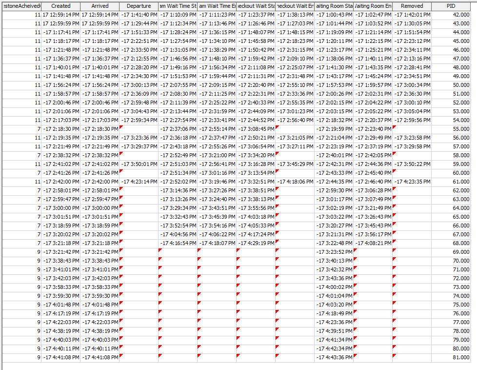

I noticed that there are now null (empty) values in the PersonMilestones table.
Do you happen to know why that is?

It seems that the state issue was indeed fixed.
However, taking a closer look at the model, I noticed that only 68 patients get to see a doctor (81 patients are expected).
The remainder are stuck in the waiting room.
This wasn't happening in the model I attached.
Do you have any idea why this would happen Matthew?
I'll continue reviewing. Any insights are much appreciated!

It looks like you're getting deadlock where one patient has the exam table and the PrepExam token has the nurse.
To me, it seems like the ExamRoomSetupProcessFlow should be acquiring the ExamTable earlier so that some other patient doesn't snatch it up before the nurse is ready. Something like this:
model-sd-39_2.fsm
