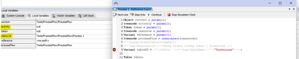

jpanY7K8B
How to access a "Resource" name "? I tried below, not working. Thank you
FelixMoehlmann
"activity" is a null value in the Count field for some reason. Use "resource.name" instead.
To check this I placed a breakpoint in the code (open code editor with scroll icon) and checked what values are assigned to the header variables (the code is executed on model reset).
jpanY7K8B
@FelixMoehlmann Thank you so much. "resource.name" works.

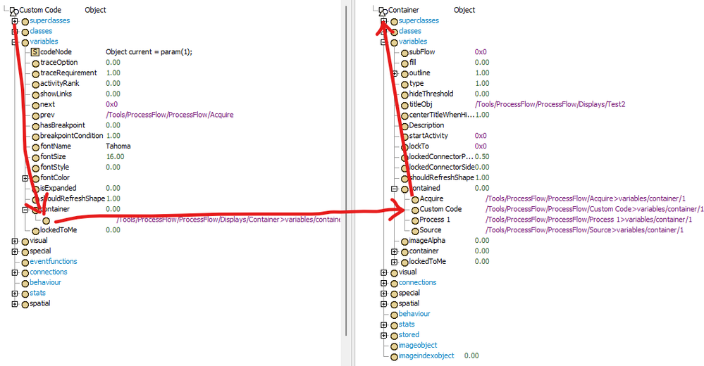

similar question: how can I use the similar code to get the container's name? apparently,  "container.name" does not work.
FelixMoehlmann
That would be the following:
ownerobject(getvarnode(activity, "container").subnodes[1].value).name
With "getvarnode(...).subnodes[1]" we start at the activity node and get the variables node that contains the link to the container. ".value" follows the pointer to the link node in the container's attribute tree. "ownerobject()" traverse up in the hirarchy until it finds an object node. Which is the container in this case.
