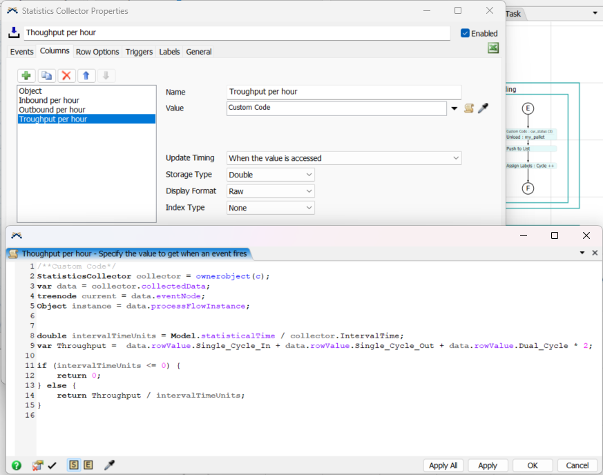

Throughput per hour was calculated using the Statistics Collector. Throughput per hour was calculated by performing the operations on token.Single_Cycle_In, token.Single_Cycle_Out, and token.Dual_Cycle recorded for a token when a token is added to the Pull from list in Processflow.
Looking at the Statistics Collector table, the data for STC_1 and STC_2 appear separately, but I want to calculate the average value. Please tell me how to do this.

You can use a Calculated Table to get the average of the throughput values.
https://docs.flexsim.com/en/26.0/Reference/Tools/CalculatedTable/CalculatedTable.html
