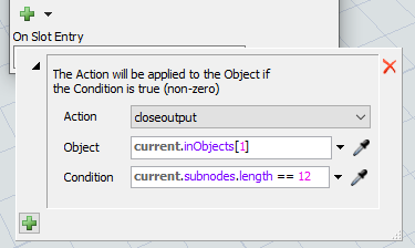

You can use the "On Entry" triggers of the rack and second processor to close/open the output of the first processor when certain content thresholds are reached.
proba_1.fsm
(I also added an extra condition to the Slot Assignment Strategy of the rack, so that only item is placed in each slot. For better visual feedback)
