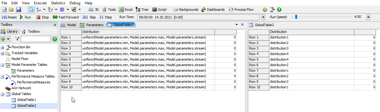

How can I refer to a statistical distribution in the Parameters table? and probably how can I change different parameters of a statistical distribution if I want to test the changes in the Experimenter or Optimizer?
For example, if this is a triangular distribution with TR(min, max, mode) how can I change the values for min, max, the mode in the Parameters table? Is it possible?

@Felix Möhlmann Thanks for the explanation! I want to use this parameter to change a processing time in my patient flow. The eprocessing times will be read from a global table and for each label the processing times are different. The values in the global table are following statitical distributions and I want to be able to change them afterwards by changing parameters in the Experimenter as you mentioned. So in the "distribution" should I use a "Set Global Table Value" under " On Set" and define which row/column I am referring to in the global table?

To populate a table with values generated by a distribution I have to suggestions. Both generate the values in the "On Reset" option of the tables.

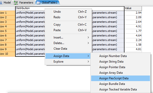

1) Define the distribution in a row of the table itself (right click on column -> Assign Data -> Assign Flexscript Data)
Then use this code in the reset option.

2) Only write the name of the parameter that the value should be generated from in the table (Assign String Data). In that case, you'd exchange the code in line 8 with the following.
current[row][2] = Model.parameters[current[row][1]].evaluate();
In both cases the generated values would be the same between runs, if the parameters are not changed, while the "Repeat Random Streams" under "Statistics" is activated. To generate a new set of values based on the same parameters, it would have to be deactivated.
