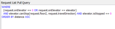

Hello.
I have a question.
Question.fsm
In my example model, the staff move patients to different floors through three elevators.
I want to make the first elevator not working after 50 seconds at this time.
It would be better if the patient and staff who were already on board stopped after the transfer.
I tried to use it after checking that there is an MTBF/MTTR function, but it is not functioning properly.
Any advice would be appreciated.

There is not a good way to do this. Unfortunately, as mentioned in this post, MTBF/MTTR doesn't work for elevator banks.
There is a workaround method where you can use MTBF/MTTR to set a label that is referenced by the request list pull query of the elevator bank. The problem with this method is that while it stops the elevator from traveling between floors during its downtime, it does not stop the people from entering the elevator.
If this is helpful, I've included an example model of this and described the process below.
elevator_question.fsm
You can create a label on the elevator within the elevator bank, called "isStopped," for example. You can add an MTBF/MTTR to your model and attach the elevator bank by switching out of the healthcare environment (and back into it after). In the down function of the MTBF/MTTR properties, you'll add a line of code that changes the "isStopped" label to 1; likewise, add a line to the resume function that changes the label back to 0.
downobject.labels.assert("isStopped").value = 1;
Then, you'll need to change the Request List Pull Query of the Elevator Bank properties so it can reference this label:
