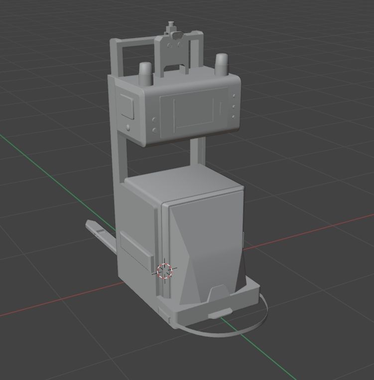

I imported a new model appearance and layers into the task executor, using the following files. My 3d model in .obj format can be imported successfully, but my layers(png) cannot be imported successfully. The effect is as shown in Figure 1. 1.jpg
Then I tried to import it using .fbx format to get an effect in Figure 2.
The plane is dark, warning light is also dim
But my purpose is: I hope to import more than one layer, and finally achieve the effect of Figure 3. The surface of the object should has a metallic luster and the small lamp will glow by itself when there is no light source.
Is there any way to import multiple layers or achieve the effect I want? I really need help.

20231028-234541.jpg figure 3

Thanks for your advice, as I showed in Figure 2, when I used the FBX files which has 3 texture layers , the model in Flexsim just showed part texture of my FBX files.
philboboADSK
1. In your Figure 2, it shows all the textures as in your Figure 3. What do you mean by "just showed part texture of my FBX files"? What do you think is missing?
2. What do you mean by "import multiple layers"? What "layers" are you talking about? FlexSim only imports material properties from the 3D shape file. If your other software package has material properties specific to its own custom renderer that aren't exported into the 3D shape file, then FlexSim can't access those properties.
3. The exact colors of each surface are different because the lighting conditions are different between the two software packages rendering the shape. Adjust FlexSim's lights using the View Style panel on the right or using Light objects from the Library.
4. FlexSim does not import lights from FBX files. If you want the small lamp to glow, you need to add a Point Light object from the Library to your object and then configure it with the settings that you want.
