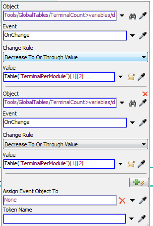

I have a process flow, where I am using one event triggered source activity to listen to 2 events. My objective is to identify the event that triggered it, so that I can reference it in my further process.
As you can see in the picture, two events are listened to, and both are global table references.
I want to identify, by using labels or any other similar identifier, which event was listened to, so that I can reference it in my further process. I don't want to use 2 event triggered sources.

To reference the Event triggered, you can type token.Event, or token.("insert desired label name") in the Assign Event Object To box. This will assign the object that was fired to a label on the token.

Regardless of how many events you listen to in the source activity, the "Assign Event Object" will assign a label with the value of the specific object that was triggered, and once it fires, the token moves on and does not listen to any other events that are triggered at the source.

Maybe you didn't understand what @Joshua S said? He said, "Regardless of how many events you listen to in the source activity, the "Assign Event Object" will assign a label with the value of the specific object that was triggered, and once it fires, the token moves on and does not listen to any other events that are triggered at the source."
Maybe that last part about the token "does not listen to any other events" is what is confusing you? The Source continues to listen for events. After an event is triggered, it creates a token with the labels on it and the token leaves the Source. The Source is always listening for any all all events. Does that clear it up?
