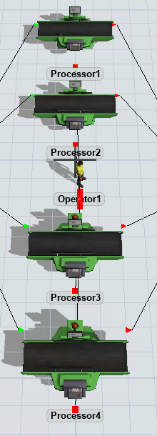

I want to build a parametric table to run the optimization
But I have a problem that the things in the group will disappear after parameterization
The scene that I want parameters is a workspace,
There are 4 work machines and 1 operator inside,
I want to optimize how many workspaces I need to meet my needs
so I group them first
like this
Then create a parametric table
Then set the reference of the parameter, and set Delete and Copy Group Members
At this time, there are still original members in the group.
But when I set it up to reset and run it once, there is only one type of member left in the group
I don't know why it happens? Do I need to set something or create a trigger?

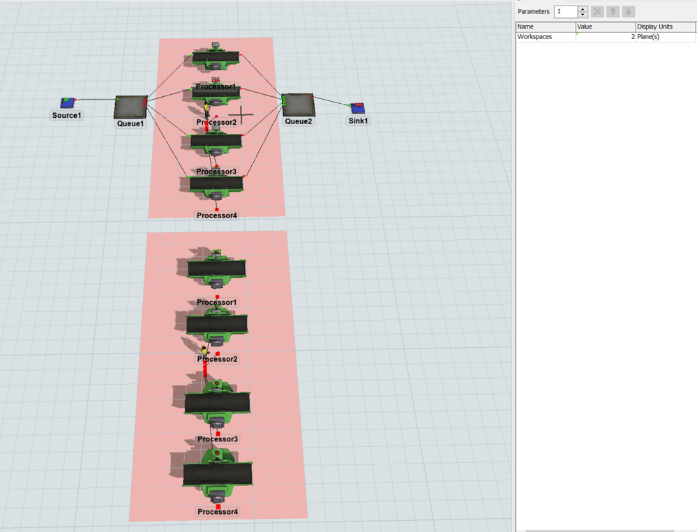

Hey @Sia Sengchoon193, great question! There's a few things I'd like to point out that may help you with your analysis.
First is that when you group the Processors and Operator together into one group and try to parameterize how many there are with a Parameter, it will only add/remove one type of object. Therefore, when you change the parameter and reset the model, the operator disappears - FlexSim thinks you just want processors.
Secondly, the reason you're only seeing 1 processor after updating the parameter is that the processors stack on top of each other when created; if you move one you'll see more underneath.
One solution is to put everything you want to replicate on a plane (Library > Visual); when things are in a plane, you can move the plane and they all move together; you can copy planes and everything inside is copied (like a mass selection). If you put the plane in a group and then parameterize the group (add and delete members), you can actually duplicate entire planes (image below). [Here's a link on how to put things in planes if you don't just drop them into one]
One downside is that the connections to things outside of the plane are not kept.
Another solution would be to put all the processors in one group and all the operators in another group and then parameterize them individually (not in planes). Then they will scale up and keep their port connections. This would be really useful to use in an Experimenter too, which can run hundreds of iterations on different combinations of parameters.
