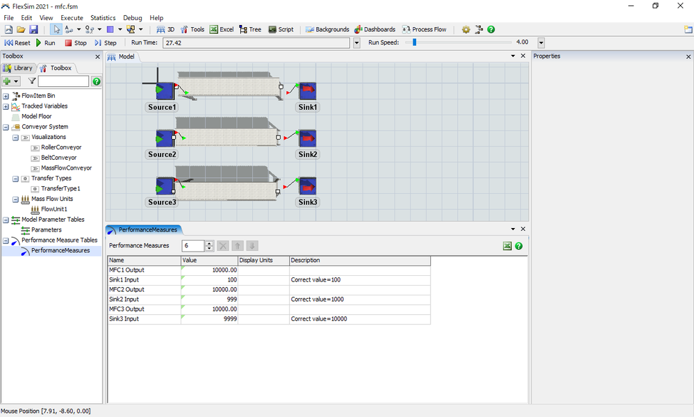

Here is a model consisting of mass flow conveyors, but it has a problem.
The three lines settings are followings:
  1. MassFlowExitTransfer1: Units per Package 100
  2. MassFlowExitTransfer2: Units per Package 10
  3. MassFlowExitTransfer3: Units per Package 1
After running the simulation, the line from source 1 to sink 1 is fine, but the line from source 2 to sink 2 and from source 3 to sink 3 has one less sink input than expected.
There seems to be a problem with MassFlowExitTransfer.
Is there a way to get the correct number of Package Items from the mass flow conveyor?

It's probably a floating point inaccurary and/or a ">" rather than a ">=" somewhere in the code determining the output.
If I use 9.9999... for the units per package (output) or 100.0...0001 for the units per item (input), I get the correct amount of output. When using enough decimal places this shouldn't realistically make a difference for a model run.
Still, I'd be interested to hear if anyone has a better idea, so I'll post this as a comment for now.

This appears to be a bug with the Mass Flow Conveyors. I just submitted a dev report, so someone on the dev team will take a look at this and/or respond to this post. In the meantime, I would just use one of Felix's suggested workarounds.

This bug has been fixed for 22.0.11 which comes out later this week.
