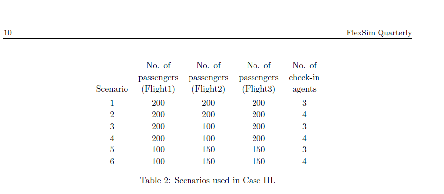

in my mode 3 flights arrival in different time and each flight consist of different passenger quantity , how to conduct multiple scenarios analysis of different passenger combination to find out the average waiting of a passenger in queue46 (note :first flight starts from source 43 ,2 flight from source 48 then 3 flight from source 49,in my model combiner are used to load the passenger in flight that arrives)i have attached different combination of passenger to be find out using scenario analysis and my model for your reference Thanks in advance for your answer.gilbert-airport.fsm

In experimenter, you can create variables for the check in agents as well as the combiner's target quantity. Here i have reattached your model.air-line-scenario.fsm.
