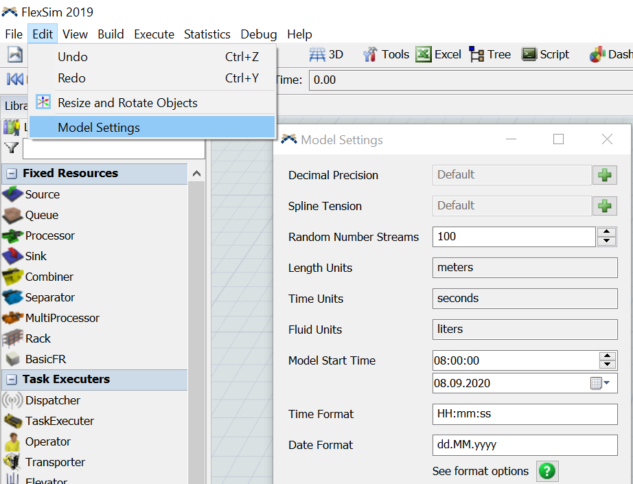

2. You can set starting Date Time in Model Settings32392-datetime-setting.png

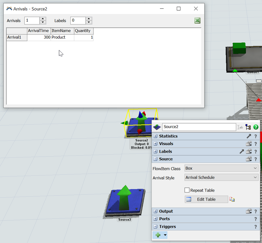

There are 2 ways to accomplish this task. The first is when using a Source in the 3D model. When looking at the properties for the source you can select an arrival style and select "Arrival Schedule". From there you can edit a table that keeps information about when items should be created and how many should be created. The time you edit in the table will be dependent on the start time of the model and the model units. (For example if you want the model to send an item at 5 minutes but your model units is in seconds you will need to say 300, like this example below.)

And also you can change your model start time by going to Edit -> Model Settings and change the Model Start Time/Date, as Joerg mentioned.
