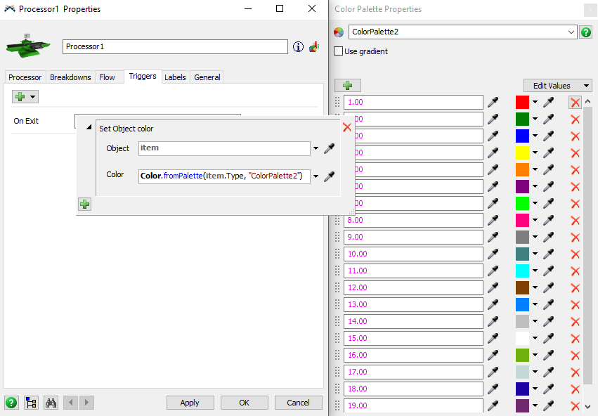

Do you want to choose the specific color for each type? If not, you can use 'Color.byNumber()' to assign a different color to each item type.
1659507070998.pngTo assign specific colors I would suggest to set up a color palette.
When using a global table you would have to enter the RGB values for the each color (0-1 for each component) and read them in the trigger.

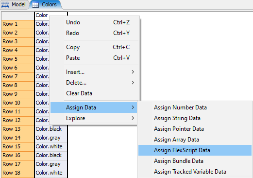

FelixMoehlmann
If you set the data type of the global table column to 'FlexScript', you can type in the color like you do in the trigger and then evaluate that cell to return the color value.
As I said above though, you can do essentially the same with a color palette (assign a color to each possible label value). The palette also allows you to customize the colors instead of just choosing from the 16 (?) pre-defined ones.
