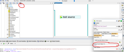

I am trying to use a flexsript code to set the value of a treenode. As you can see on the image below, the node is expecting a coupling data. I wonder,  what is the line of code if I want the results in processflow to be "token.queue".

You can't assign a direct reference to the node since it needs to be dynamic. Toggle the node as flexscript and assign the script to return the token label. You can check out the default header for that field by opening the code editor for it.
Noting that the token gets passed in as "param(3)" you can shorten this to the following.
treenode activity = ...;
treenode assignTo = getvarnode(activity, "assignObjectTo");
assignTo.dataType = DATATYPE_STRING;
switch_flexscript(assignTo, 1);
assignTo.value = "return param(3).as(Token).labels.assert(\"MyQueue\", 0);";
