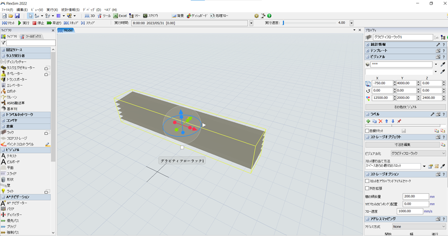

A customer of mine reported that the GravityFlowRack was not displaying correctly.
The version the customer is using is FlexSim 2022.0.11.
When placed by dragging and dropping from the library, it will be displayed in the following state.
When I had the customer confirm it, it seems that there is no problem with the setting of tree information and reference data.
If reinstall the FlexSim version to 2022.0.8, it will be displayed normally, but if change it back to 2022.0.11, the problem will be reproduced.
Any probable cause and possible workaround?

Confirmed with the customer.
The storage system visualization GUI is displaying correctly.
I have one more piece of information.
When the data created with Ver22.0.8 is opened with ver22.0.11, it is displayed normally, and even if it is newly placed from the library, it is displayed normally.
However, if you create a new one and place it from the library, it will not be displayed properly.
I hope you find these information useful.

We would like to inform you that we have found the steps to reproduce this issue.
I have found that this problem can be reproduced if the length unit is set to millimeters in the model units. This problem occurs not only on gravity flow racks, but also on regular racks.
However, this problem occurs with FlexSimJapanese2022.0.11 or later. It does not occur in FlexSimJapanese2022.0.8 or earlier and the English version.
thank you.

There are 2 things going on here:
1. Rack visualizations are not being properly scaled to other model units in a localized FlexSim. So rack objects won't draw correctly in model units other than meters. We'd have to update the localization file and make a new Japanese build to get this working.
2. The Gravity Flow Rack doesn't draw correctly (even in meters) because the localization file translated Gravity Flow Rollers incorrectly. You can fix this in the model though by changing the name of the top グラビティフローラック visualization to グラビティフローローラー. (This issue is already fixed in FlexSim Japanese 23.0.8)

I was able to confirm that it was displayed normally when I placed it newly in the English version. However, if you open the model created and saved in the Japanese version with the problem in the English version, the problem will occur. Is there a way to fix it from this state?

A model saved with the incorrectly scaled visualization elements won't be fixed by opening it in 23.0.9.
You can fix the model by changing values in the tree. The Storage System's visualization elements have various length and position values that are not scaled correctly to be in millimeters. If you were to multiply these values by 1000 they'd be correct. For example, here's a script that seems to fix the model you attached.
