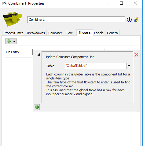

jose_antonio_mad
Hello @Sara W,
Here you have some screenshots to help you.
In this link you have information about this function (It's old, but the idea is the same): https://www.flexsim.com/flextips-update-combiner-components-list/
In any case, I would recommend you the last version, there are many improvements since your version. If you don't have a license for the new version, you can contact with your local distributor (FlexSim Iberia): https://www.flexsim.com/contact/#Europe
