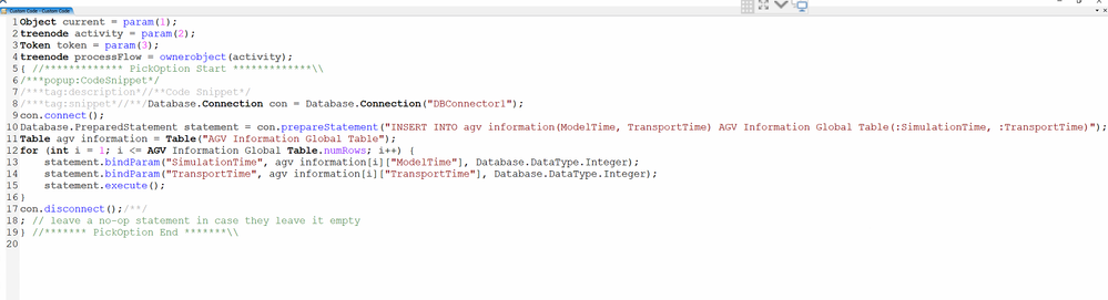

Hello everyone, I have let information of agv (e.t.c. traveling times a day or every load time) into global tables. And I want to export these data instantly to SQL. I have been looking for the answers on Flexsim doc and Flexsim community, but it all failed. Both of the coding on these two page will have system console. So, I want to know is there any other method to solve this question? Thank you so much.

Which "two pages" are you referring to?
You connect to your Database using the database connection and prepare a statement with the INSERT INTO syntax required.

aa0976382405
Thanks for your reply.
Both Flexsim Doc and Flexsim Community.
Below is the code in Flexsim and system console will always appear.
Message 4 of 9
joerg_vogel_HsH
I don’t have any knowledge to this case, but I think an assignment of Table agv should be completed before you prepare a statement that a compiler interprets as system code.
Message 5 of 9
jason_lightfoot_adsk
Do you have a space in the table local variable between 'agv' and 'information' ? That would not be allowed.
This looks like a space between "agv" and "information" - that's not allowed.
