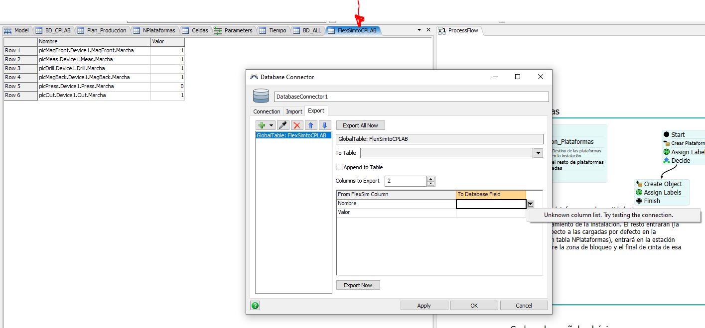

[ FlexSim 24.1.1 ]
I am trying to export a Global Table “FlexSimtoCPLAB” from FlexSim to a MySQL Database. I have tested the connection with the database and I use HeidiSQL for managing this database. Previously, I imported data into this same database and it worked perfectly.
The DatabaseConnector tree appears as follows:
Where it can be seen that the exporters node does not have the subnodes that it should have. It can be seen that in the tableList node, two subnodes appear corresponding to the two tables I have in my database, but the names do not appear.
In the following image, I have observed in a model that I downloaded from this forum that the export node does expand and has subnodes and the tableList has name
When I want to make the export to DB, but it does not show this table created in the database, and therefore, I cannot map the columns.
What am I doing wrong? How is it done?
I had to configure the root user with the authentication plugin:
mysql_native_password.
because the "caching_sha2_password" was giving me an error.
The version of MySQL I am using is 8.0.26.

The following is a workaround to be able to write the table name in the database connector. Since the UI will not allow you to select the table you can write the table name in the tree. The following is an example path to the node.
MODEL:/Tools/DatabaseConnectors/DatabaseConnector1>variables/exporters/1/tableName
I did not have the UI open when writing the table name. This will prevent the UI from overwriting what you wrote in the tree node. You can open the UI after you have added the table name.

In the TableFlexSim node, I wrote the name of my table. To map the columns, I also had to add the names of the columns ("name" and "valor") that I pointed out with a red arrow and that belong to the destination table (TableFlexSim)
I noticed that when adding the second column, the names of the nodes From FlexSim Column and To Database Field do not appear, this is right?
I understand that this is a manual solution that only allows interaction with one table and that the BaseDate Connector selector does not work well. For a second table, would I need to create another purple node like the one I circled in the image?

For the second collum names the nodes do not seem to be named but if you select the nodes you will see the values filled in that you have in the table in the UI.
If you need another table, in the UI select the green plus sign in the upper left and create another export. You will see another purple node created like the first.
