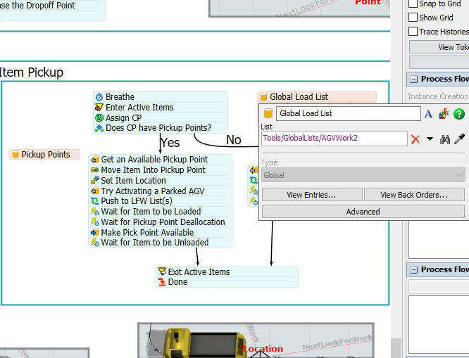

I have two problems in my model that i can't fix.
First when the plane is loaded this error appears, i've tried to fix this but i don't find the error.
Second, i have two independent paths but the AGVs from the last path start moving when it's supposed to be the AGVs from the first path to move.
The other path i have i control it by the process flow.
I'll leave here the model if someone can help.

For your second question, each AGV group needs to be separated by a different process flow if you want them to act independently. This can be done by adding another AGV Process Flow:
Then duplicate the Global List "AGVWork" in the toolbox menu and call it something new.
You also need to go into the new process flow (AGV2) and find where it says "Global Load List" to change the list to the new one. This should free up your AGV groups to move independent of the other.

Hi, i've take a look at what you have done and yes, i can see the recquire number on the "Pull from List" and yes, he solved the problem. Thank you!
About the second one, that also solved the problem of them always moving around while there were no bags in the Queue "Saída Avião".
