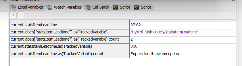

from examples and answers from the forum (e.g. https://answers.flexsim.com/questions/80701/graph-multiple-data-of-a-tracked-variable-in-one-c.html, https://answers.flexsim.com/questions/177837/performance-measure-from-tracked-variable.html) the following syntax should work to update tracked-variable labels:
myObject.myLabel = newValue;
or
myObject.myLabel.as(TrackedVariable).value = newValue;
However, as one can see below, the only working syntax is using the "labels" format:
myObject.labels["myLabel"].as(TrackedVariable).value = newValue;
It also fails when reading the variable content:

Both examples you linked use Tracked Variables from the toolbox and the references point to the node in both cases, making it possible to cast the reference as TR and read the property.
Using object.labelName gets the value of the TR-node, a number, which can not be cast as a TR. You do in fact have to use the object.labels["labelName"] syntax to get the TR/Label-node and access properties of the TR.

@guiroehe Those two examples you referenced are not "incorrect syntax", they both work. For example,
reference.as(TrackedVariable).maximum
This works because reference returns a node and the node can be cast as a TrackedVariable.
What's different about your situation is that you're using the dynamic label property "statsItemLifetime". This doesn't return a node. It returns the value of the "statsItemLifetime" label node. To get the actual node of the label node you have to use the object.labels["labelName"] syntax.
