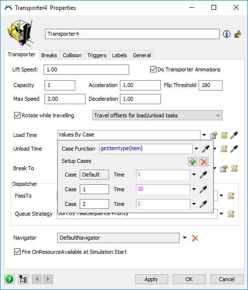

I’m building a model were I try to replicate parts of the attached model (warehouse picking demo from a previous question). Unfortunately, I’m struggling with implementing pick time per item. When I increase the amount to be picked at a given location the transporter does not use more time at the station. I find this a bit strange as it should take more time to pick 5 items compared to 1.
Does anyone know where in the model the loading time per flow item is decided?

You can adjust the load time per item in the Task Executor properties window . The field where it says "Load Time" defines how much time per item it takes to load. I've included a simple example.

@Kristoffer Sperre in response to your second question this is what I came up with (see attached model). I sent flowitems from a source to two racks, and set a trigger in OnCreation to Set Itemtype.
I then told the source to send corresponding itemTypes to separate racks (since you wanted the transporter to define load time based on which rack it is).
Finally, I set the load time on the transporter to vary based on the itemType.
