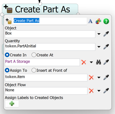

Hey @jlandrum4QA5V, if you want to have an initial amount of inventory in a Queue, you can use Process Flow's Create Object activity.
You can start with a Schedule Source to create a token. Tokens flow through activities, executing whatever logic they contain. In this instance, I create 1 token at the beginning of the model. I give it labels for the initial inventories.
Then I use Create Object activities to create X number of boxes within their respective queue.
Now, when you start your model, you'll get an initial inventory in your Part A and Part B Storages.

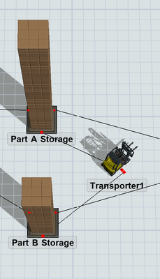

Hey @jlandrum4QA5V, I think the issue is that you're trying to control the Transporter's movement with Process Flow and use it with 3D connections. The 3D connections (Part A Storage -> Sink1) using a transport will automatically allocate the Forklift. Your Process Flow was also using to grab boxes and wait. You'll have to go with one method only. Either remove all 3D connections so Process Flow can handle the logic for the transporter:
Or keep the 3D connections and disable the Process Flow source so the 3D connections have full control.
Most users prefer the Process Flow route because it allows more accurate and precise control of your processes, easier scaling, and centralization of model logic.
