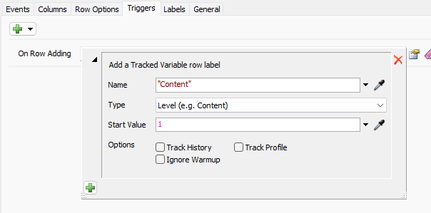

In my model, I have both boxes and pallets with boxes stored. When I do the counting, the box and the pallet count as 1, regardless if the pallet contains for example 5 boxes.
How can I make it counting the total boxes?
I am attaching my model and the picture that best describes the problem.
Additional point: If you count the boxes/pallets, in the picture and compare it with the model, it is always adding 1. I cannot understand where this additional 1 is coming from.

The offset of 1 stems from the row label starting at 1 instead of 0.

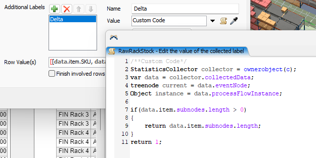

To account for pallets, change the "Delta" value to either return the number of subnodes of the entering/exiting item if there are any and 1 otherwise. (Negative values for exit event)

So then, I would need to modify the Delta to the custom code you have shown. Does it needs to be done for the On Slot Entry / On Slot Exit? or only for one of them?
Message 6 of 9
julie_weller
For both, and the slot exit would be the same code but negative for the numbers to return

I did the change as you mentioned and the values in my dashboard completely dissapeared. (Dashboard 2/XXXRack Content by SKU.
Aslo, the Systems Console started showing some lines that were not there before, related to the Statistic Collector that were modified.Example with expansion.fsm
Message 9 of 9
moehlmann_fe
1. There is a spelling mistake in the code(s).
2. You have to return the negative number of subnodes for the exit event.
