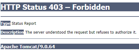

Thank you for your solution. It seems that I encountered an error while downloading the model file. I'm not sure if it's because the file upload failed on your end. Could you please upload the model file again? Thank you!error.png

Sorry, the forum sometimes loses attachments when editing a post.
queue-openoutput-order-fm.fsm
