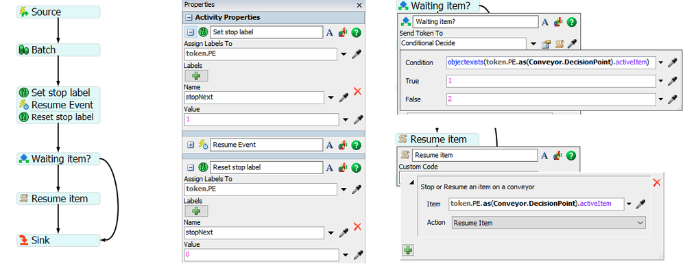

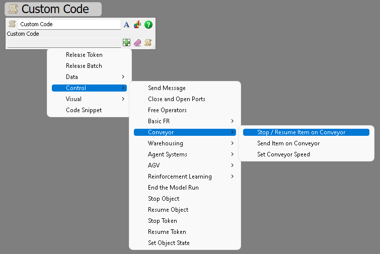

You'll need to use Conveyor.Item.stop() to stop an item on a Conveyor (and any upstream items that follow). You can also use a Custom Code activity with the dropdown option Control > Conveyor > Stop / Resume Item on Conveyor:
Or with a Decision Point's triggers:
The tricky part is getting the right item to stop, since the 30th item that triggers the 500 seconds of stopped time is different than the 31st item that is actually stopped. The easiest way to handle that would be to have the 30th item set a label somewhere, like on the Conveyor or in the Process Flow, and then use that label in part of your logic to determine when to stop the 31st item.
Then, the same part of the logic that sets the label will wait for 500 seconds before clearing the label and resuming the 31st item if there is one (in case it takes more than 500 seconds for the 31st item to arrive). Again, you'll probably want to use a label to keep track of which item is stopped, and then use that label when resuming the item after the 500 second delay.

In this particuar case, I would suggest to use the "Stop Item and Delay" option of a Photo Eye (or Decision Point). A label on the Photo Eye determines when the next item should be allowed to continue onto the slug conveyor. Items are only stopped if that time is larger than the current model time.1662531334322.png
This way, you only have to set the label on the Photo Eye to stop the input to the slug conveyor. Resuming the flow happens automatically at the specified time.

Then you can do as Logan suggested: Stop the item based on a label and later resume it from the process flow. For this you can first check if there is actually an item waiting at the photo eye in a decide activity.
