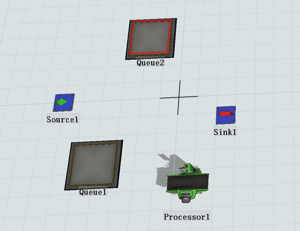

I'm randomly dragging Fixed Resources I need ,and I bulit a global table
Is it possile to make connections between fixed resources and global table to auto connect fixed resources?
Cause I have to add new nodes in connectsin&connectionsout , I don't know how to do it

I'm not sure from your post if you want just to make the connections from a line definition that is stored in the global table, or if you want to alter the layout too.
This will do the connections.
contextdragconnecion(<fromobj>,<toobj>,"A");
If you want to align them just create a loop and set each object's x location to that of the predecessor plus that object's x size plus a margin.
Object posobj=Model.find("Source1");
double y=posobj.location.y;  //align in y
double margin=0.2;
double x=posobj.size.x+posobj.location.x+margin;
while (posobj.outObjects.length>0){
    posobj=posobj.outObjects[1];
    posobj.location.x=x;
    posobj.location.y=y;
    x+=posobj.size.x+margin;

Thank you for your reply , I just want to make the connections from a line definition as well as arrange their positions from x\y\z in my global table.
My intention is to create a GUI where I can import different tables ;each table has the information I need to auto connect&arrange my fixed resources
