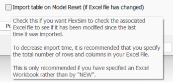

Hello @Pert P,
When importing a table from excel into a global table you can select the following so it updates.
In terms of random number generation a stream will generate the same sequence of random number for that stream. The only worry you run into is whether all the objects in your models use the same streams as the other model. This is where you can run into some statistical problems when comparing 4 different models vs comparing one model with 4 scenarios. In the single model each object will have the same number stream that is used for each object in between scenarios. In the 4 different models you do not necessarily know what number streams are used when you compare object between the models. With that being said you cannot compare replication 2 of model 1 with replication 2 of another model. You may be able to run a statistically significant number of runs of each model and compare the aggregation of statistics of each model with each other. I am not a data scientist though so I am not sure I have considered all the problems you need to consider when comparing your statistics.
