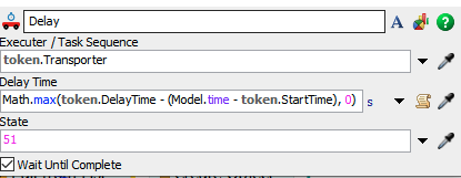

luis_rodrigues
In the "Dealy" feature how can I get the states that I defined?
Message 19 of 28
moehlmann_fe
You can't. The delay task can only change the default profile. You have the change other profiles separately (before the token enters the Delay task activity).
Message 20 of 28
luis_rodrigues
So for example, in this I make it "state 13" and when it goes to the delay it won't change to "state 50" ?
