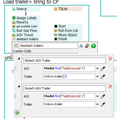

in my model i create 2 trailers and attach them to a task executer. parralel in source 6 items where created. This items (token.item) will be batched in two batches (token.loadbatch).
the first problem is to load these batches to trailers. i get error messages like this:
time: 36.358016 exception: FlexScript exception: Invalid down cast. Object is not an instance of the target type. at MODEL:/Tools/FlowItemBin>packing/Simple c: MODEL:/Tote1 i: MODEL:/Tote1/1
second problem is after loading. my train drive to controlpoint and should deattach trailers (token.trailer). but after deattaching there ist only one trailer left.
the aim is to unload trailers with crane (TSlist) and pickup trailers when unload is finished.

Hello @Andreas BH,
The problem was that the push to list activity pushed a token instead of an item. Also, the split activity wrote over the item label in your split activity.
I revamped your process flow to finish out the tasks you asked for. I utilized subflows in a few places to control the repetitive processes. It is a lot to completely recap, so please review the model and let me know what you have questions about.

The only problem i have following: When the TE is shortly before the controlPoint both trailers are lined up. (picture 1)
But after undettaching bith trailer are stacked.(picture 2)
The crane unloads 6 items. When TE attached trailers again they are lined up, again.

andreas_boehmer
Hi @Jeanette F
i found the reason why the trailers are stacked after deattaching. If you deattach at first the first trailer, second trailer automatically fills the gap. Than they are stacked.
We have to deattach at first the second trailer. Than it works fine.
