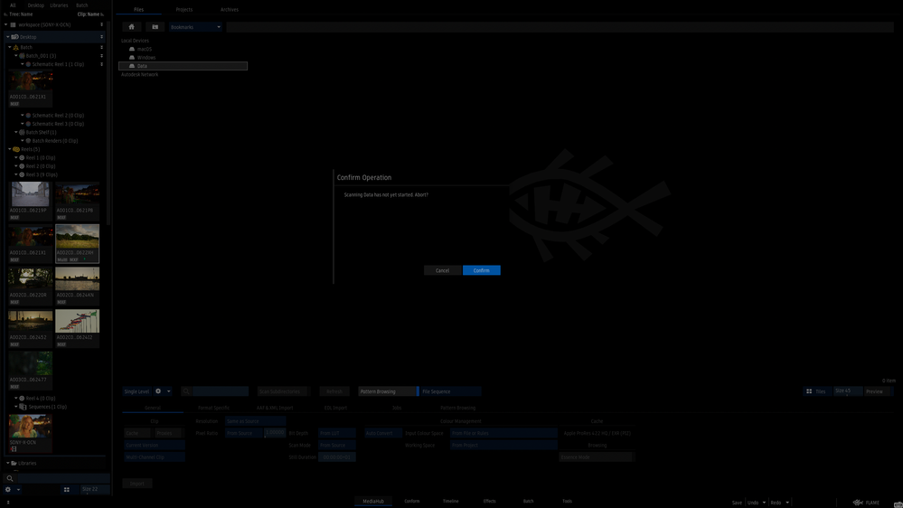

I can't open my footage disk in Flame 2024.2,software prompts:scanning data has not yet started.I work on mac os 12.6,and"Full Disk access" to be enabled.

slabrie
This is an issue that has been reported by many users but we have a hard time replicating it in our lab.  Please open a support ticket so our agents can't investigate the issue and provide details s the development team can fix the issue.

sztom998
安装flame以后会在完全磁盘访问里添加一些后台运行服务程序,都需要勾选上,我看你里面是空的,是不是安装的时候没有授权给它。

109541625

kexianliang
System Integrity Protection status: disabled.
System Integrity Protection will prevent applications and services from reading or writing in some areas of the file system.
Granting Full Disk Access to these applications and services will be necessary to make all features available when System Integrity Protection is enabled.

slabrie
It is not recommended to run with SIP disabled. You should always keep SIP enabled and ensure Flame Family products and services have Full Disk Access enabled to ensure smooth operation on macOS.

kexianliang
  • This issue only appears in MacOS version of FLAME, Linux version does not have this issue.It's so annoying and irritating , I am looking forward to this issue completely disappear in the future.

109541625
Later I found out that the address in the host was changed when installing nuke, and it was fixed after restoring the host. But recently this problem started to occur again, maybe the network environment has changed, annoying problem
