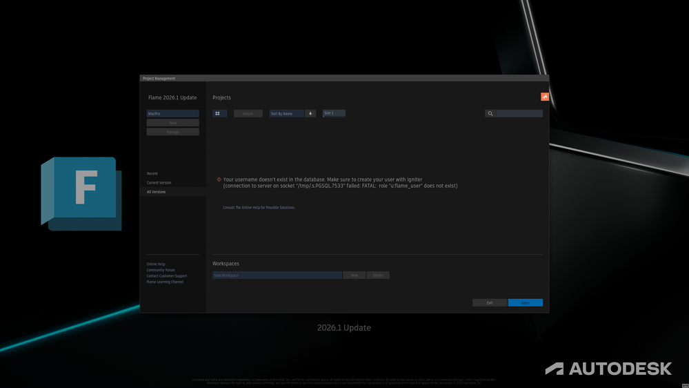

kexianliang
I am curious about how you connect Flame to an external (compared to Flame's built-in Postgresql) Postgresql database, and what settings need to be made. I have tried connecting Flame to Postgresql18 on the default 7533 listening port, but it was not successful and prompted to create users through Igniter. I hope Flame's support for Postgresql databases can be more universal, rather than being locked to specific versions bundled internally.

fred.warren
Hello @kexianliang,
It is not possible to connect Flame to an external PostgreSQL database. Many tweaks are made to Flame's database to offer the best experience possible.
