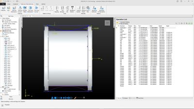

Hello everyone,
From several days my status bar in right bottom corner missing.
Maybe I or a colleague have changed something in Options Dialog button?
Can anybody help with problem?

bhorstTGM48
I had this problem as well, I think it is hidden behind the task bar. I had to do this to fix it.
https://www.screencast.com/t/kVPTNrCU
ChristopherMarion
Hi @grandeurvox
Just like @bhorstTGM48 said.  It may get hidden behind the task bar.  I've had this happen in the past.
There is no way to turn off the status/information bar in FeatureCAM.

grandeurvox
Thanks for replies, but no results...
In some reason it don't show

ChristopherMarion
Hi @grandeurvox
Perhaps your INI file is corrupted.  It happens from time to time.
I would try:
  1. Closing all FeatureCAM sessions
  2. Navigating to C:\ProgramData\FeatureCAM - If this folder is hidden, you may need to make it visible.
  3. In this location, take the ezfm_ui.ini & ezfm_ui.XML file and copy to your desktop
  4. Open FeatureCAM
FeatureCAM will re-create these files automatically.
Let us know if this worked.
You will need to re-setup your settings in FeatureCAM since everything will revert back to factory settings.
