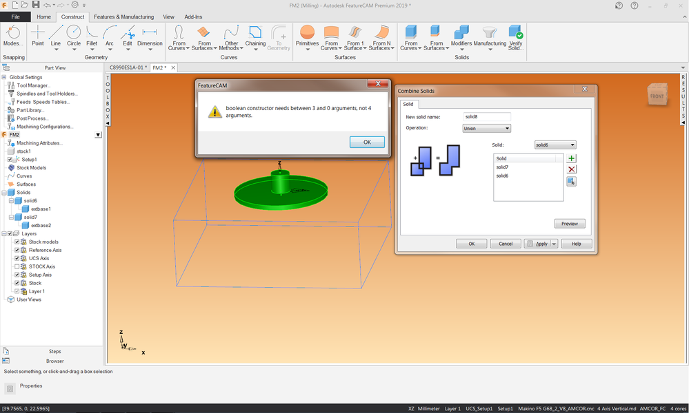

Combine solids error

Not sure why the first post disappeared so here it is again. *mods please message me if you dislike my post*

I just tested it in the same version as you and I also received the same error 😞

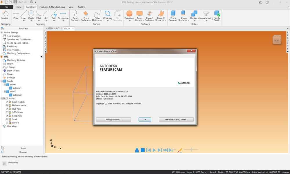

I found the customer support number and got the work-around from there...*drumroll*
Uninstall the 2019.1.1 update
(Control Panel > Uninstall > Programs > Programs and Features > Installed Updates)
Apparently it is a known issue that the devs are currently working on.  Reference number: FCAM-3338
2019.1.02019.1.0
bhorstTGM48
This issue seems to be fixed in Autodesk FeatureCAM 2019.1.2 Update that was released today.
