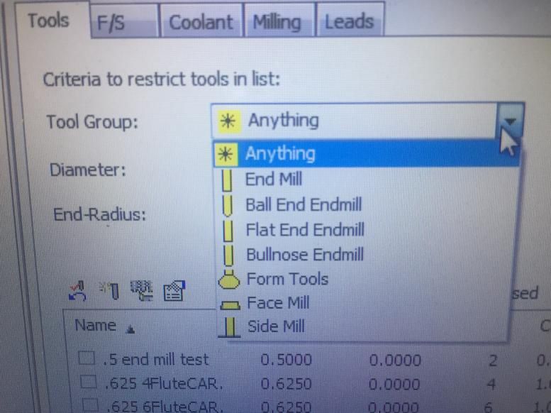

I need to change that tool anyway as surface tool selected is a square end mill. Here is some additional info on the model/file:
The first 11 operations simulate well.
The underlying 45 degree chamfer geometry and chamfer surface recognition looks good for the last 7 ops ... but I get no cutting in simulation.
It is possible that the problem might lie with my inexperience with tool management.
AFR picked surface milling for these seven chamfers, but did not pick the 45 degree chamfer tool I have defined in my crib
and I am having trouble getting the chamfer tool substituted into the operations.
When I go to the Operations List, double click the tool I want to swap for my chamfer mill ... the Chamfer Mill tool group is not there:
This is only my third project with FeatureCAM and I am likely missing something.
Any suggestions on a work around to get the chamfer tool into play here and help me get back on track?
Thank You for your time and assistance!!!
Bruce
Message 5 of 16
I've never used AFR, so I don't know what assumptions it makes.  I can't tell for sure, but it looks like that's a planar surface. I don't see a reason to use surface milling for the chamfer. You have side features, so the easiest thing to do is to add a chamfer on your dimensions tab.  Chamfer mill will be available in the operation.

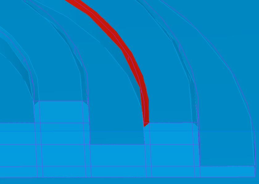

Going IFR, picking intersecting surfaces to chain curves to build the features got me three perfect depth chamfers and smooth simulation on the chained straight and rounded sections. NICE!
On the other five edges to go, I have tried for a couple days to get curves at the surface intersections and I am encountering two types of issues in creating the necessary curves.
The first is that I select two surfaces and instead of building a curve at the intersection, it creates multiple vertical lines on one of the faces:
Selection:
When I hit finish ...   I am creating a string of vertical lines under where the curve should be from the intersection of the two faces, but trying repeatedly, I just can't seem to get the curve to form at the intersection.
I click on one of the vertical lines and get the message "Selected Curve36_6".  So it looks like I am actually creating a curved surface defined by a string of vertical lines rather than one curve at the intersection of the faces.  I have tried selecting surfaces in different orders, etc, but no luck at creating a curve at the top of the surface I can think of and still am missing something there.
The second issue is that I can create an intersection on two milled surfaces on one curved raised pad, but when I try to do the same on the next pad up, using the same procedure, I get the error that there is no surface-surface intersection.
Successful preview intersection:
Unsuccessful preview:
This is puzzling since the two surfaces were designed/milled exactly the same and I am using the same selection procedure ... the only difference is the second is .050 higher.
Can you offer any suggestions as what I might be doing wrong ... or some alternative to try to get the curves in place?

Have you tried making a side feature with an chamfer then turning it into a surface using surface from feature?
Or just make a side feature  with a chamfer out of the curves you have.
Message 10 of 16
I'm not positive that I understand the issues, but I wouldn't use Intersection for what you're trying to do.  I would use Surface Edges.  I know that in this particular case they're not where you want them to be because of the chamfer.  So I would create a curve using Surface Edges and then translate the curve in Z.  However, the easiest way to program those features would be to use IFR to create a side feature. As I mentioned before, you can adjust the top of the feature when you get to the location part of the wizard.
Message 11 of 16
SUCCESS!
Creating a curve from a surface edge worked perfectly for generating curves for all eight of the necessary chamfers in my test model:
With that command, I generated the curves, features and had the simulation working in ten minutes!!!
