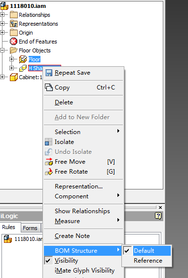

Hi Martin,
As default, floor and pit assets is Reference in BOM structure. So they will be invisible (display as dashline actually )in Inventor drawing.
You need to change them as Default( Normal) in BOM structure in the assembly.
-Xuesong
Please mark as a solution if somehow I got it right.
martin_madaj
Hello Xuesong,
Such a simple solution and I haven't figured it out by myself. Thank you!
