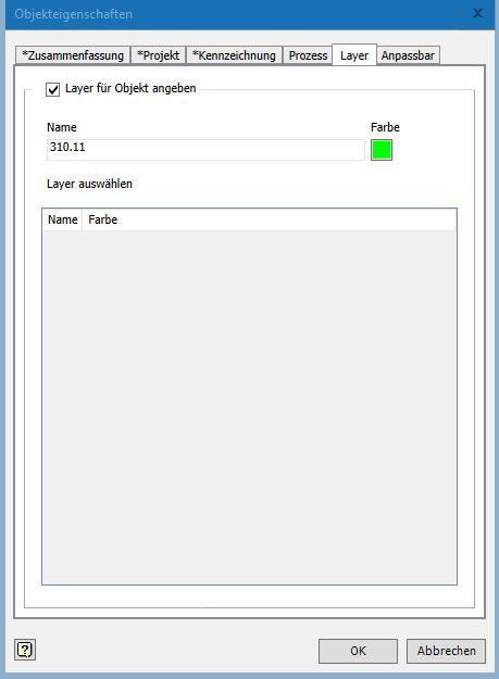

i`m running into an issue with the FDU 2019 API.
The Layers seem to work now, but only to a certain extent. When Layers exists within a Layout, i get an iLogic error message.
More workflow datails here:
Screencast API Layers
How can this be avoided? Am i missing out on an API Funktion somewhere?

Hi Mickey,
We are using solely "Automatic Layering" function in FDU.
These Layers are all predefined in our Assets.
The Layers are defined with the Asset builder here:
The API works well when publishing Assets without a Layer preundefined, as shown here:
But deleting Layers out of all our Assets is no Option for us. In 2018.2 all works fine.

Hi Mickey,
The issue we had with 2018.2 was that the inserted Assets were all on Layer 0. Allthough the assets were published with a Layer.
With FDU 2019 the Problem should have been fixed. It does work now. But as soon as two same assets are placed in the Layout, iLogic responds with a message:
Autodesk.Factory.Core.Data.Exceptions.FactoryDataModelException: Unable To create 310.31 layer for layout
   bei FDM_InventorAPI.FactoryData.AddFactoryLayer(Document layoutDocument, FactoryLayerModel layerModel)
   bei Autodesk.Factory.InventorFDMUtility.DataModel.LayerHandler.AddEntitiesMethod(Object nativeDocument, IList`1 entitiesToAdd)
   bei Autodesk.Factory.Core.DataModel.EntityHandlerBase`1.AddEntities(Object nativeDocument, IList`1 entitiesToAdd)
   bei Autodesk.Factory.InventorFDMUtility.InventorFactoryDataModelUtility.AddLayers(Object targetDocumentEntity, IList`1 layers)
   bei Autodesk.Factory.Core.PublicAPIImpl.FactoryAPI.Autodesk.Factory.PublicAPI.Currency.v2.IFactoryAPI.AddAssetInstances(Object Layout, IAssetInstance[] instances)
   bei ThisRule.Main()
   bei Autodesk.iLogic.Exec.AppDomExec.ExecRuleInAssembly(Assembly assem)
   bei iLogic.RuleEvalContainer.ExecRuleEval(String execRule)
 I only used: API.Autodesk.Factory.PublicAPI.Currency.v2.IFactoryAPI.AddAssetInstances(Object Layout, IAssetInstance[] instances)
The FDM_InventorAPI.FactoryData.AddFactoryLayer seems to called by AddAssetInstances itself
 What is needed is a verifcation if the Layer exists so that the Funktion FDM_InventorAPI.FactoryData.AddFactoryLayer will not be invoked again.

Hi Mickey
We can Import our Layouts again, once the "Automatic Layering" function in FDU is switched off.
The only thing is, that we can forget to turn it on again, when we insert assets the conventional way.
Is Autodesk working on that bug?

Hi Yizhou,
The issue has been fixed with the 2019.1 Update.
Thankyou.
