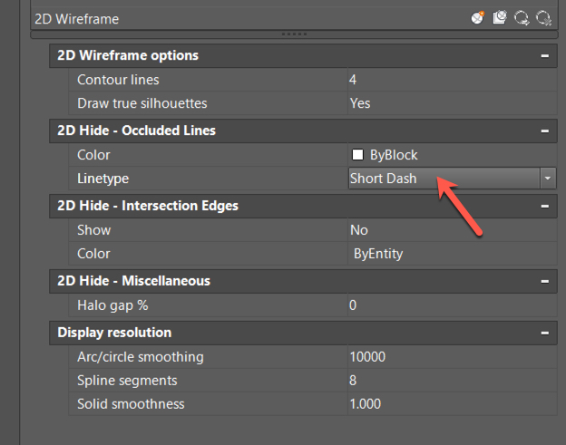

Is there a way to get a MvPart to show hidden under a piece of duct drawn in Fabrication CADmep, without converting it into a Fabrication "Part"?

  Sorry for such a long delay in getting this over to you, but here is a file with the issue that we are having.  Any help would be appreciated.  I have two different parts in the drawing just to show that it is not only that specific part that is being blocked.
Dan,
I just tried it with changing the linetype under HLSETTINGS, 2D Hide to short dashed.  Play around with that, it should work.

  Thanks for the help!!   I have been screwing with that for close to a year, and you figured it out in under 5 mins.......  WTH?!?!?  ha ha
