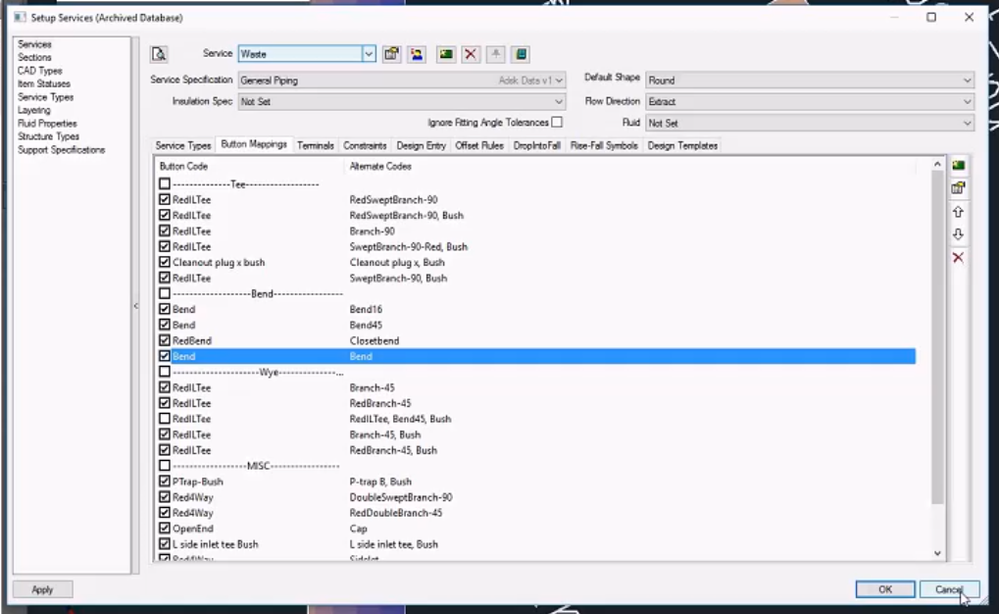

I do have two workarounds that may be of interest.
First if you would like to keep the design lines separate, you are going to have to take off the "Tee" fitting manually, by placing it on the node.
Or you can tell CADmep to apply a "Tee" fitting to the bend node using the Setup Services folder, as the very last option for Bend - see image below.
Setup ServicesSetup Services
The last method is more of a trick, and not a typical workflow method, but I wanted to provide as many opportunities as possible.
Please let me know if this helps you, and if not kindly reply back to this forum and we can continue to troubleshoot.

I'm having this exact same issue trying to connect a vent service design line to a sanitary service design line. Was this issue ever properly resolved? We make sanitary to vent connections throughout our models and this will be a big issue for us. We've just recently started using this software and ran into this almost immediately.
Is there a way to connect two separate design lines from two separate services using the same pvc material? To where the sanitary tee would populate?

There is no solution, but what i did was meet both systems halfway.Vent,san.jpg
Message 12 of 15
ZTR88
Ok... But if you were to spool that to be fabricated it would have that extra small piece of sanitary pipe in the top of the san-tee and the vent pipe would be too short correct? That's the conclusion we've come to.
...And without being able to snap the vent pipe into the hub of the sanitary tee manually, that cut piece for fabrication will never be accurate.
